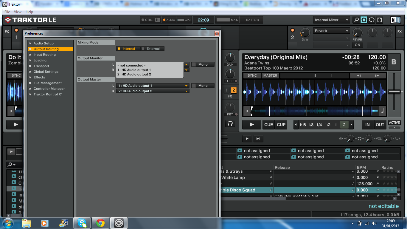

I am running my Mixtrack Pro with Traktor 2.5 Pro, everything is dandy except I can't get any sound through my headphones.
In my output routing I have Master 3&4 (speakers) and monitor 1&2 SPDIF interface and I don't have speakers connected directly to my Mixtrack (ie in the output ports in the back), they are just connected to my computer.
I get audio through speakers Ok, but I can't hear the cue channel through my speakers no matter what I try. Any help would be greatly appreciated.

Why not use the mixtrack pro to monitor the cue if the playback is coming from the mixtrack pro as well?
Mixer Mode: Internal
Master- mixtrack pro 1/2
Monitor- mixtrack pro 3/4 -

I don't know how to configure traktor but I still have no sound on my numark headphone port. Do I have to change audio setup or output routing???
You will need to change your audio setup inside of tractor

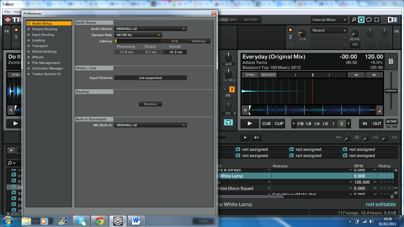

i have set my audio as ASIO4ALL with MixTrack pro under the WDM device list, however i do not get options 3 and 4 for my output monitor, nor can i set 1 and 2 for the output master, any help will be much appreciated
Send a snap shot of your software's audio routing config menu.
You don't have to use ASIO4ALL. Try without ASIO4ALL first to make sure. -

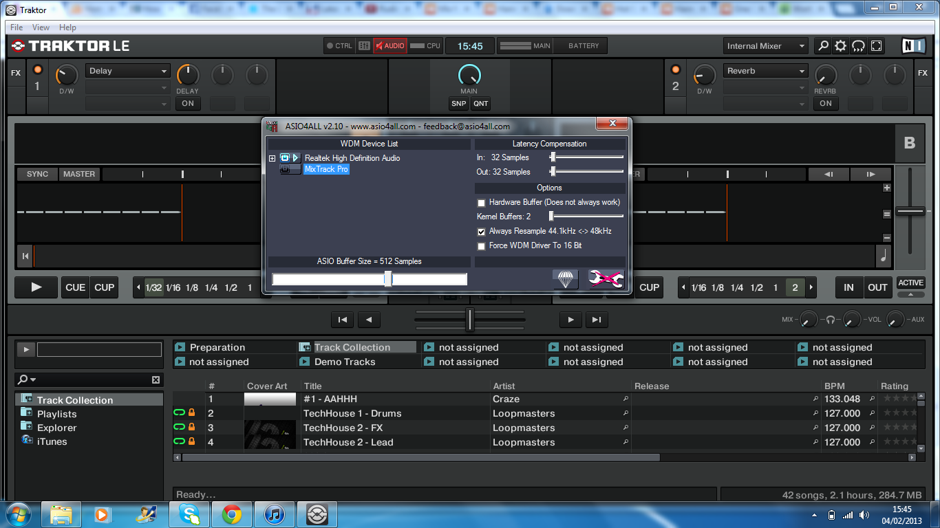

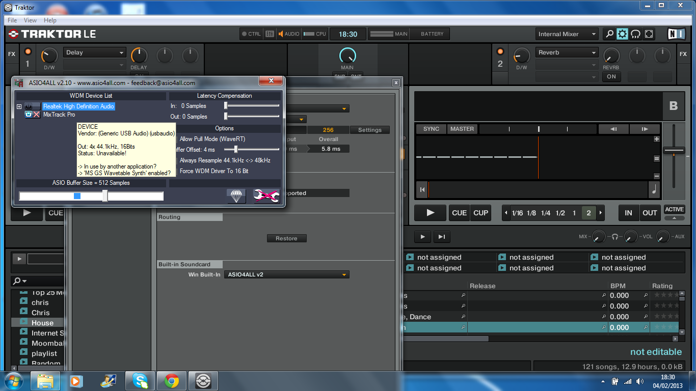

Hi Chris,
Can you also send us a pic of your ASIO panel so i can tell if you have the right setup? -
To get your ASIO panel you will need to click on your task bar on the bottom right of your screen and click on the icon for ASIO4ALL. This panel will show us what devices are being used by the Asio drivers.
Hi Chris,
You will need to press the power button to the left of the "Realtek High Definition Audio and turn on the power button next to MixTrack Pro. This will connect the proper channels. -
